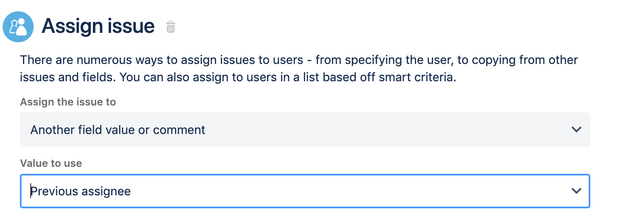

I believe using Project Automation, you would have the option to select previous assignee
Try that and see if that works for you

Hi Hazwan,
Thanks for the answer.
What if the previous assignee is not the person in progress? There is another status in between which may cause problem with use of previous assignee.
Any other alternative to pick the assignee based on the status of the issue.
