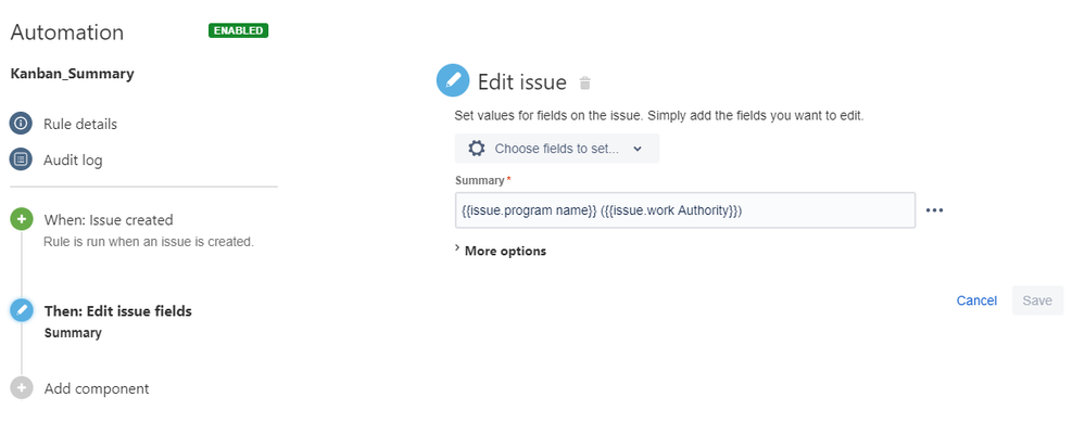

I have the Automation for JIRA downloaded on our server. I am trying to get it set up to where a summary field is created automatically to ensure that the field is consistent across all issues.
Here is the link I found that I cannot figure out how to use.
I would like the summary to update with the following fields in the format as shown:
{{Program Name}} &" "& {{Lot Number}} & " (" & {{Work Authority}} & ")"
I know the language is incorrect on that coding. I am very new to JIRA and am trying to figure it all out.

Hello Kian. Yes they are custom fields. I took out lot number for the immediate time being, but below are screen shots of what I am seeing.
Preston,
This is because you need to have a summary when you submit the ticket. If you are setting it via an automation rule, it doesn't matter what you put, the automation rule will override it with the value you've specified.
If you want the value populated WHILE you are filling out the form, automation for Jira cannot do that. Instead, you'd have to look at something like behaviors which come with the Scriptrunner plugin. That requires actual groovy scripting, so it's a bit more complex.

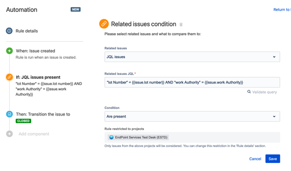

Preston,
Given that you are automating all of your summaries based on the custom field values, would it be more accurate to say that if two tickets have the same values for all the custom fields, the one just created should be closed?

Yes that statement would be correct. If all custom fields are the same, it needs to close.
Use a simple condition, it has the ability to do an "is empty" check for a custom field.
As for the other part, try this:
Essentially you would be checking if there is another ticket already matching all the values entered for this ticket. If so, transiton to closed.
If not, proceed with the rest of your automation.

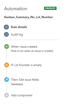

So I can't find how to do the if/Else and If Then. From what I can tell, that is only available in the Pro Series. Is that correct?
I see. I didn't realize you were using the free version.
It's nowhere near as nice to do with the free version, but it is possible. You would need to split up the rules into three separate ones.
The first would check if there are any duplicates. If there are, it would close the ticket.
The second and third would the be other conditions we discussed. So one rule would say "If the Lot Number" is populated, do this, and the other would check if the Manufacturing Number is in existence.
Not as easy, but it is possible to do.
I also tried out the transition Close Duplicates, and I created two duplicates, but nothing. Did I do something wrong?
No subsequent actions were performed since JQL condition did not pass due to error running JQL:"(key IN (PST-17) AND ("Lot Number" = 5 AND "Work Authority" = 4306))" - The operator '=' is not supported by the 'Lot Number' field., The operator '=' is not supported by the 'Work Authority' field.
Your field types must be text, not number.
Try with the operator ~ instead.

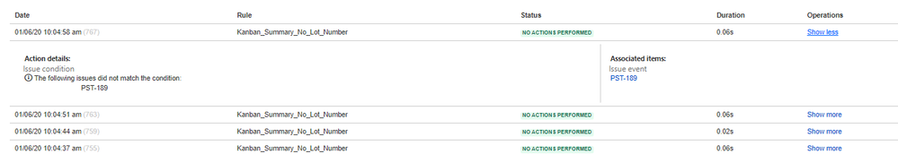

I was using the below and it was working, but a few weeks ago this code stopped working. to the best of my abilities, this should still be working. Can you help?
{{issue.program name}} {{issue.Manufacturing Number}} ({{issue.work Authority}})
The names haven't changed but it is responding with the Manufacturing Number being null (even though there is data).
Hey Preston,
Can you show us a screenshot of the results of your code, along with the configurations of the automation rule? Is it just Manufacturing Number that isn't working?
Kian
Preston,
According to this, your automation rule isn't running since it doesn't match the conditions you've set out. IE - Lot Number is not Empty. It won't perform the automation you have.
