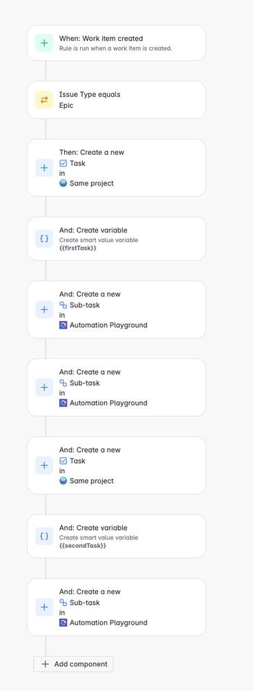

Since you mention the tasks are always exactly the same, you can create them automatically (and starting from where you were in your workflow) like this:

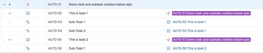

These are just the steps to create the different tasks and subtasks. Executing the rule results in this output:

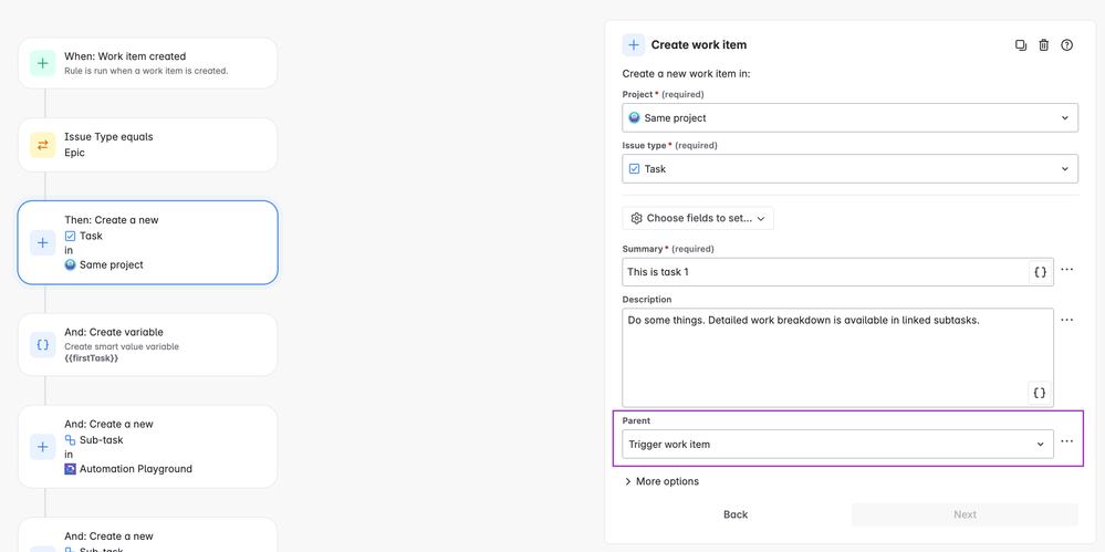

to link Task 1 and Task 2 to the triggering epic, I set the Parent field in the create work item like this:

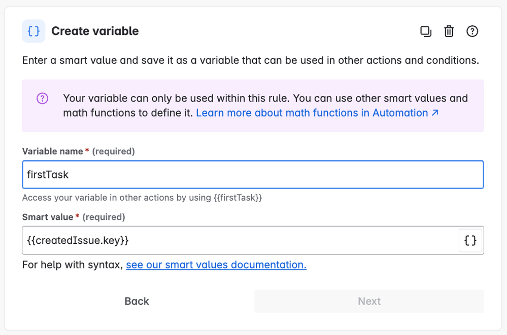

After I create a Task you can see that I am creating a variable (twice). I am using this because I need to be able to link the subtasks I am creating next to that task. I am using a so-called smart value to temporarily store the key of the task I just created and reuse it to link all sub-tasks later on:

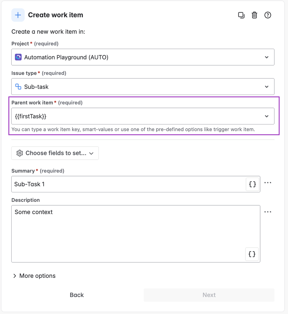

To link the sub-tasks to the correct parent, I am using a reference to that variable like this:
That should do the trick initially.

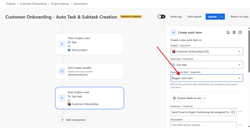

I tried these steps and got stuck at this point (Shown in picture). I can only see 'trigger work item' and 'Current work item' as the drop down options. And cannot add the smart value added in the variable step above as a manual text. How can this be resolved?
Walter Buggenhout
May 26, 2025
Yes you can, but you need to be persistent 😛
You can see where the cursor is blinking. Just start typing {{ReadytoOnboard}} and press enter when you've added the smart value there. It should stay there then.

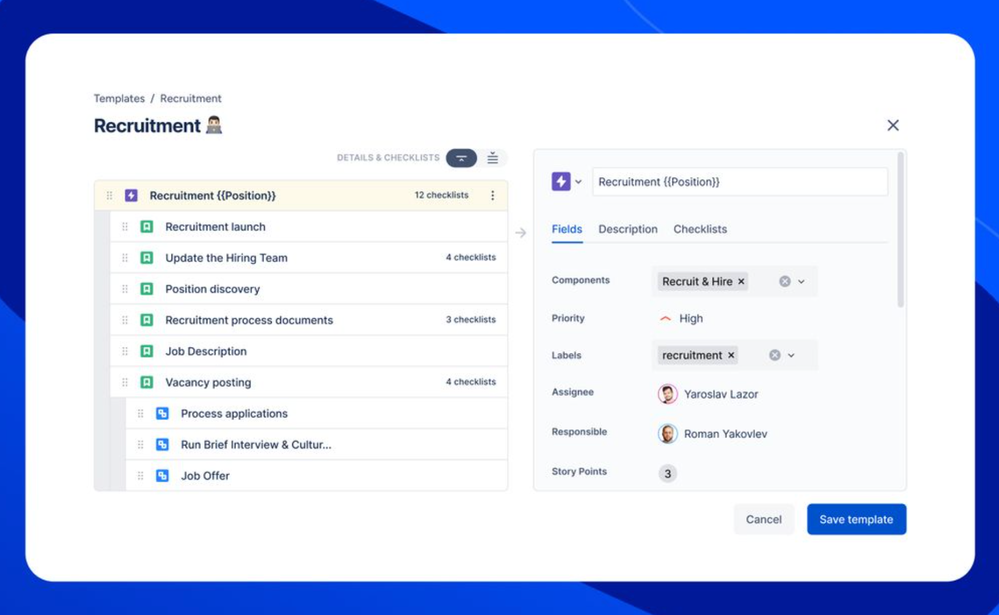

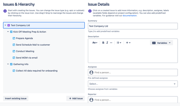

Hi @Sooraj  ☺️ If you're open to using a third-party app, I think templating.app could work very well for you. You can easily create issue templates for hierarchies epic, issue, subtask.
Afterwards, you can create all of them in a project with just one click:
You can find us at the Atlassian Marketplace: ➡️ https://marketplace.atlassian.com/apps/1224664
I rebuild your use case so you know how this could look:

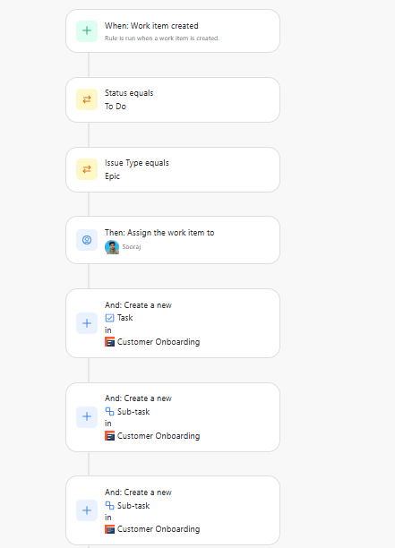

Hi Walter,
Thank you for your quick response. Here is the screenshot of current setup. I am not sure if this is the right way. I am doing automations in Jira for the first time.
