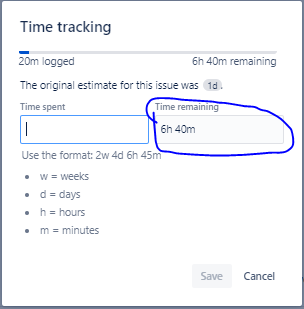

To do so click on the Time Tracking where you Logged and Remaining Time is visible
and it will open the Time Tracking window, where you can edit the Time remaining accordingly.
