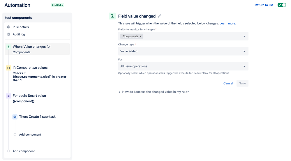

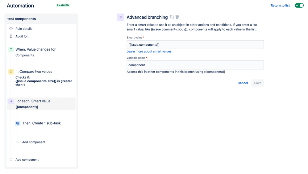

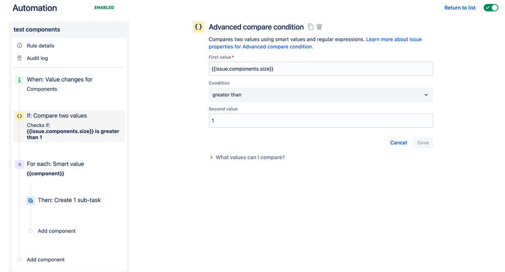

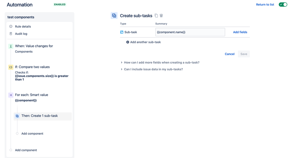

I am not sure what your exact use case is, but I think you could achieve your goal with the following automation rule:
This rule gets triggered if a new component has been added to an issue. Then, it checks if there is more than one component set on the issue. If so, it creates a new sub-task for every component assigned, where the name of the sub-task is the name of the component.

Tushar February 12, 2025
Hi ,
The automation rules works for creating subtasks for components, but it should create subtask summary for each component. The result is showing subtask summary as "combined component" names.
Story A is having component A, B and C
Current automation rule result as:
Subtask 1 with summary - ABC
Subtask 2 with summary - ABC
Subtask 3 with summary - ABC
Expected result should be like:
Subtask 2 with summary - B
Subtask 3 with summary - C
