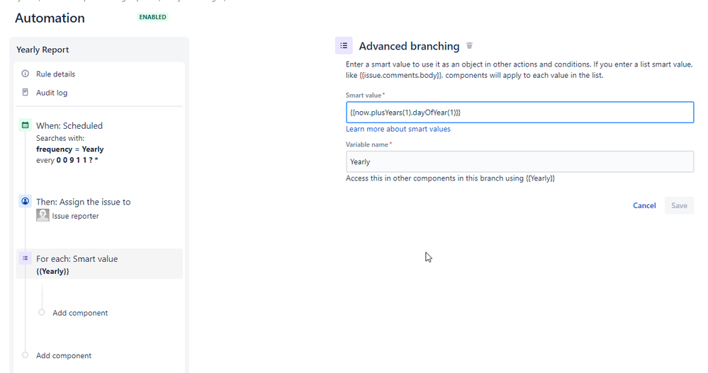

Mary Kasinger February 14, 2023
Hi Bill,
Sorry for the late reply, and thanks for your answer!
I ran this task to test it out, and it failed. Attached is a screenshot with my current automation - do you think there is something incorrectly set up on my end? You'll see I have the smart value entered in the "Advanced branching" condition.
I am trying to schedule this to have a due date on the first of every year, and I want this to be also run on the first of every year. I want to do this for my monthly and weekly reports as well, but I figured if I can get the yearly one set up then I can figure out the other ones.
Bill Sheboy
February 14, 2023
Hi!
My understanding was you were trying to set the Due Date for specific time frames, and so...there should not be a need for an advanced branch in the rule.
  • If you want the rule to trigger on that date/timeframe, set the scheduled rule schedule using the selections or a CRON expression, and then create the issue and set the Due Date.  As {{now}} will match your date, setting the field is straightforward.
  • If instead want to run the rule at any timeframe, and then create the issues and set the date for the desired value using a smart value expression.  Please look at the example expression I provided for the first of the year.
So the question is: when/under what conditions do you want to create these issues and set the Due Date?

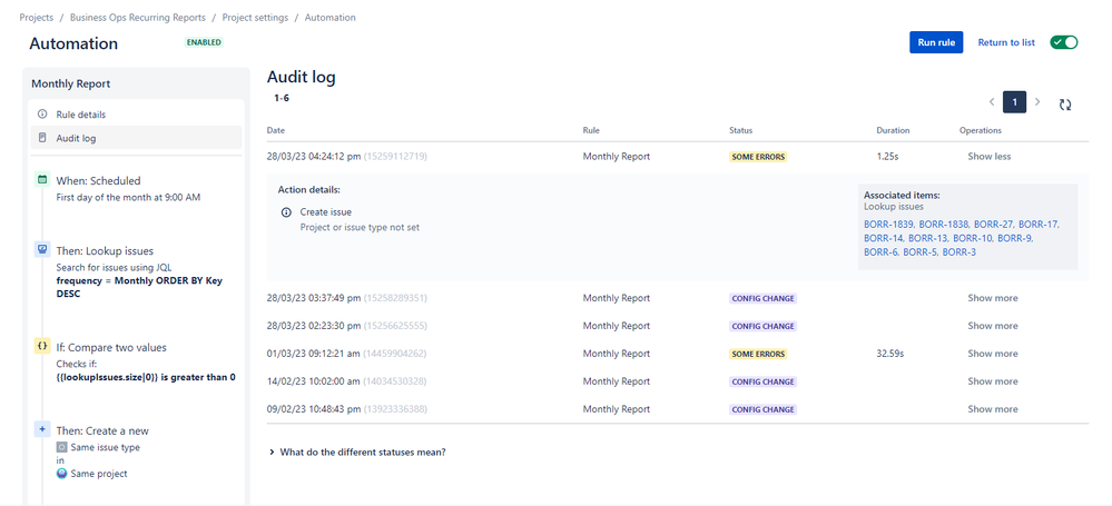

Mary Kasinger March 28, 2023
Ah, I will look at this log moving forward. I am getting some errors (see below). Not sure what the error "project or issue type not set", but no new issues have been created. I did run it just now, apparently it didn't run the first time. Still no new issues.
Bill Sheboy
March 28, 2023
Yup...there are no issues from the trigger...from which to copy the project or type.
In your issue create, if you select the project and issue type from the dropdowns the error will be fixed.
