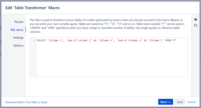

You can use the Table Transformer macro for this purpose. Wrap the Pivot Table macro in the Table Transformer macro, rename columns and build a chart based on the transformed table:
Use the the similar SQL query:
SELECT 'Column 1', 'Sum of Column 2' AS 'Column 2', 'Sum of Column 3' AS 'Column 3' FROM T*

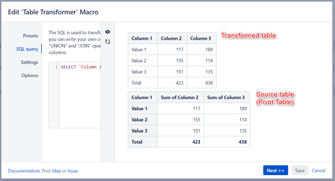

The result is  the following:

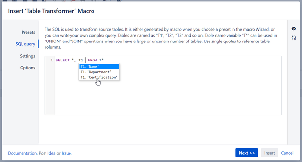

One more hint is when you type T1. you can see all the columns from the first table and just click to select the column.

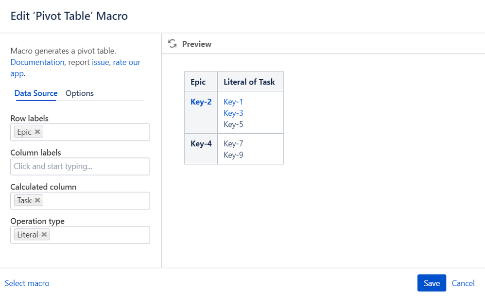

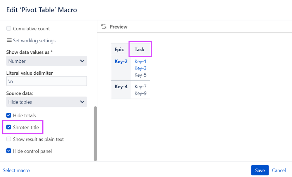

December 21, 2022
Hi @Ramesh PS,
Starting with the Table Filter and Charts for Confluence version 9.6.0 (Server/Data Center) and 20 Dec, 2022 for Cloud, we’ve made an improvement to the Pivot Table macro: such prefixes as “Sum of …”, “Literal of …” etc. can be eliminated.
