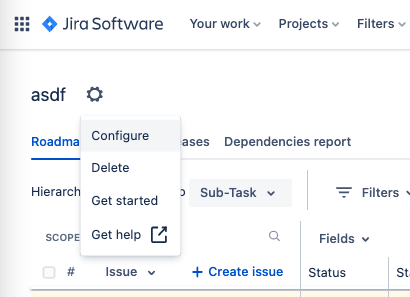

The dates can be changed in the plan settings, by selecting the cog icon next to the plan name and choosing configure:
Then under the General Configuration > Scheduling you can choose a custom date field for the scheduling to use for start and end dates here:

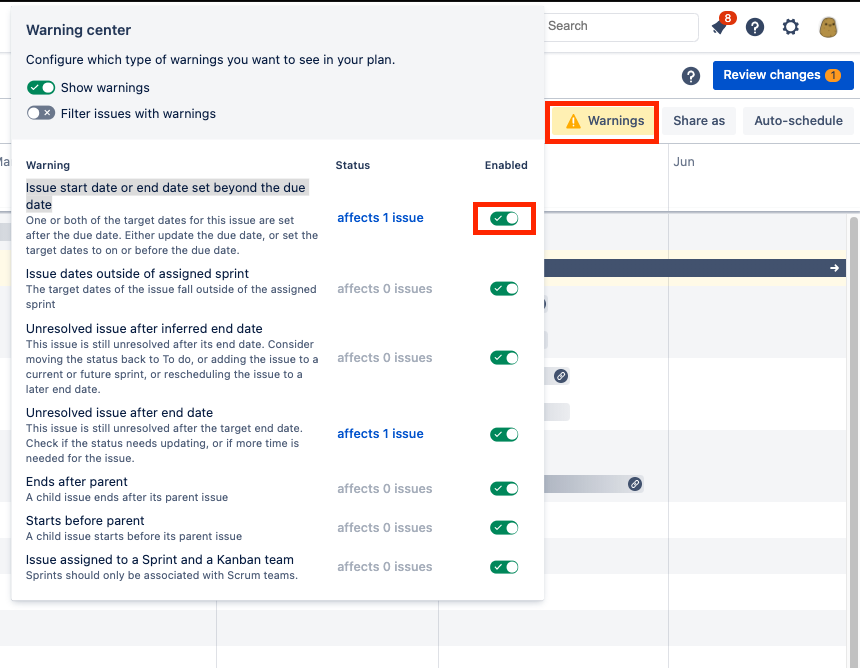

If you are not relying on the due date fields in any way, and only plan on using the custom field for the calculations, and tracking, you can disable the warning by selecting the "Warnings" icon in the upper right of the plan window and deselecting the checkmark slider for "Issue start date or end date set beyond the due date", allowing you to bypass the check as it does not apply to your configuration for the desired date tracking in the plan.
The option is located here:Screen Shot 2021-08-04 at 11.18.09 AM.png
