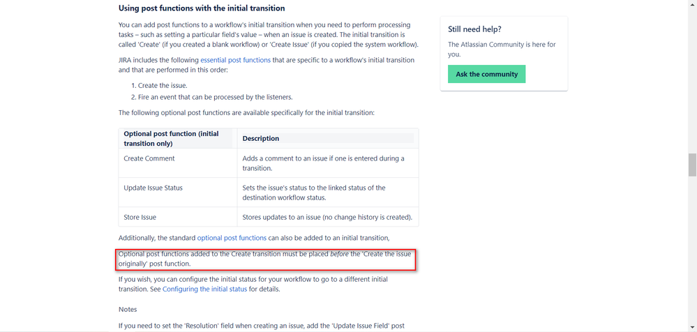

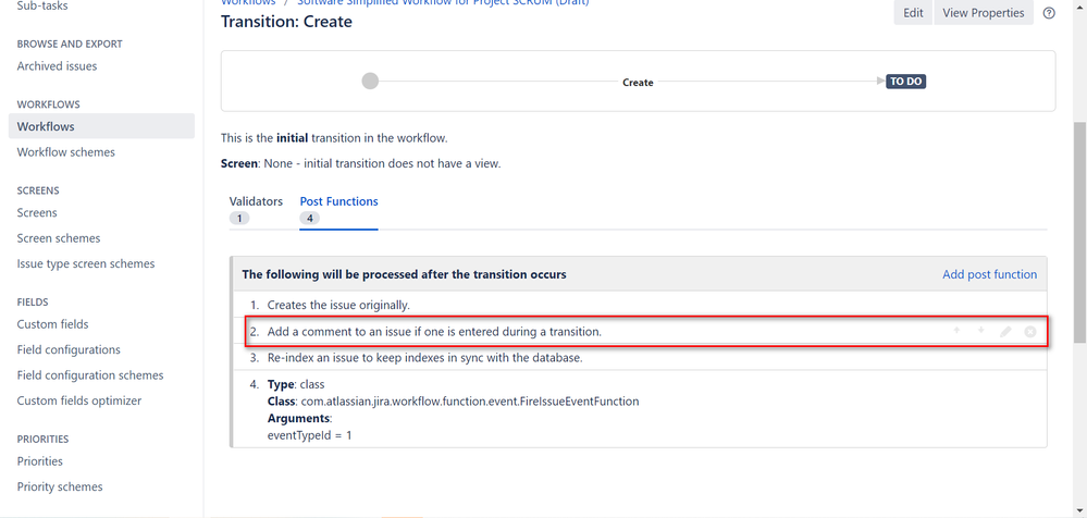

As the documentation stated, I tried to change the order of post functions.
I've added optional post function-create comment. But I can't place it above the 'create the issue originally'. Therefore, I can't see any change after adding it.
How can I change the order?
(I've tried to change the order in other status(steps) than 'initial status' without encountering any problems.

Nic Brough -Adaptavist-
January 22, 2021
Sort of, but it's hard to explain with single words like "update"
I want to explain it via the lifecycle of create and update:
There is no issue existing
  1. User hits create, and gives Jira a load of field data, and we get to the post-fuctions.  At this point, we have a ghost of an issue, not an actual issue.
  2. Create issue initially post-function runs, turning the ghost into an actual issue
  3. indexing and event firing happens
  4. We have an issue, and we decide to move it from new to in progress, so a transition is done
  5. The transition creates a ghost copy of the existing issue and the user makes changes to it (if there's a transition screen.  If there isn't, then the only user change is to where the issue is in the workflow)
  6. Post functions are started
  7. The data in the ghost is written back on to the existing issue
  8. indexing and event firing happens
Issue transitioned.
Now, if you want an automatic field change, you can use a post-function.  But you need to amend the ghosts during the transition, not the issue itself, so the post-functions need to be done before the "write ghost to issue" step.  So they need to be placed between processes 1 and 2 for create and between 6 and 7 for the transition.
The problem for this case is that comments are not a field.  They are not part of the issue, they are notes about the issue although they can only exist when they are in the context of an existing issue.  When you're transitioning an issue, you have an issue context for them.  When you're creating an issue, you don't have that.
January 22, 2021
The "create comment" function only works when you are commenting on an existing issue, and there is no issue here until after you finish creating it.  So you can't do this, no matter where the post-function is placed.
Why are you trying to create a comment on a new issue?  If you have something to say about the issue when it is created, that should go into the issue, not be a comment.

change_the_order_of_post_functions_2_20210122.pngThanks for replying.
Meaning the statement is not testable?
Would you mind telling me what's the difference if I add these optional post function(create comment, update issue status, and store issue)?
Many thanks,
Christina
