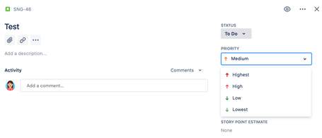

The priority can be changed directly on the ticket, the field shouldn't be blocked even if there is a default value.
If you click to open the ticket, it can be on a board or backlog, you should be able to click on the priority to show the options:
If you are not able to see the options, can you please let us know if you are facing this issue on all next-gen projects?

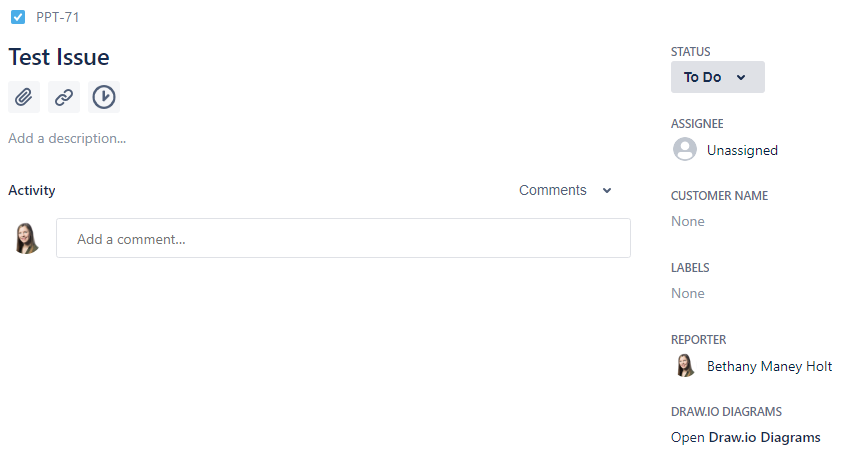

I don't see the option for priority. All our users are facing this issue. I will try your suggestion.

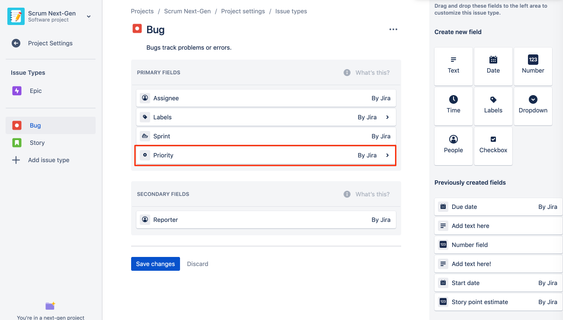

If the field is not visible, maybe it was not added to the screen.
Please, go to the Project settings > Issue types > Select the desired issue type and add the field.
It should be on the "Previously created fields", so just drag and drop on the Primary Fields and save the changes.
Yes, I see it now under Previously created fields. Thank you so much!
I went to issue types and added priority and saved. But I am still not able to see priority on opening issue
I had to add this in for each issue type using the left menu bar. See if that works - first time I tried I only changed the settings for 'Bugs'
