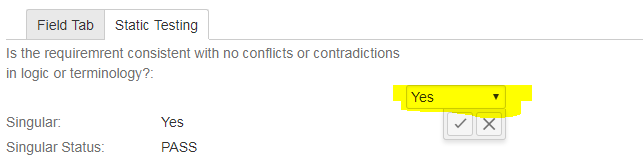

Below is the screenshot of the view screen after applying the code. Width modified as expected. Value - Yes

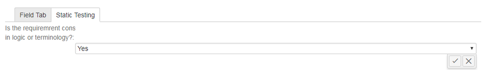

Below is the screen when i want to change the value and click on options
After changing the value from the drop down, see the below screenshot width is back to normal size

Ho great!! it is working.
Only one issue is there. When i can click on the edit of options, drop down is expanding and coming to the next line as below.
Get the element of the dropdown, and reduce it's width
Hi Nir,
Sorry for the late response.
I have reduced the width and changed the position too. But if i click on edit, options drop down coming to the next line.
