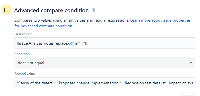

Hi @John Funk ,
I am using "Issue Transitioned" trigger.
I used "Advanced compare condition" find the attachment below:
Please let me know if I am doing anything wrong.

Hi @rbalamu2 do you have any plugins available to you? This would be a perfect example of the need for a screen behavior, a feature of Scriptrunner. Short of that all I can suggest to you is to remove the default value, or test in your condition that the value of the field is both not null and also that the value of the field is not equal to your default value (reflecting edits to that default value).
