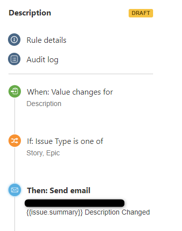

I have a rule to send an email when the description of an issue changes. However, a lot of these changes are due to users fixing typos, punctuations, etc., where there is not a meaningful change in description.
My current plan to fix this is make a rule that only sends an issue when the description changes by more than two alphanumeric characters. That way fixes in punctuation and small typos will not trigger it.

I've attached the (very basic) rule setup I have so far.

Hi @Quang Nguyen
Have you tried to use the change log and compare the differences in field length, before and after?  Then use an advanced compare condition to check against your threshold value.
For example:
{{#=}}{{#changelog.description}}{{fromString.length()|0}}-{{toString.length()|0}}{{/}}{{/}}
