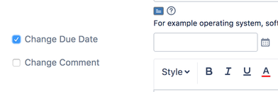

Bulk update selecting (enable the checkbox near) "Due Date" option, with EMPTY field should clear the field.

Yes, I tried leaving the field empty as in the screenshot and it cleared the field.
