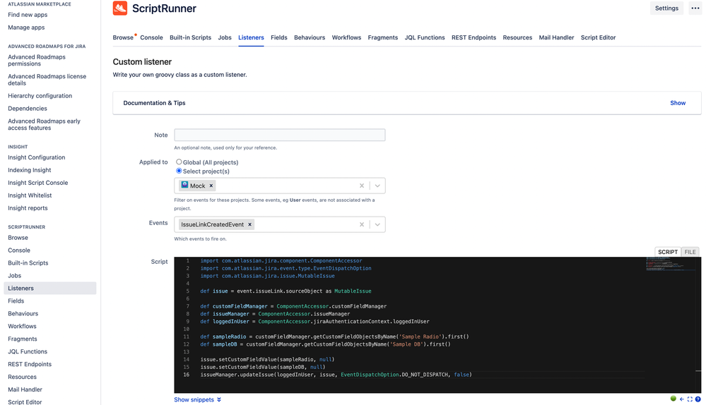

Below is a screenshot of the Listener configuration:-

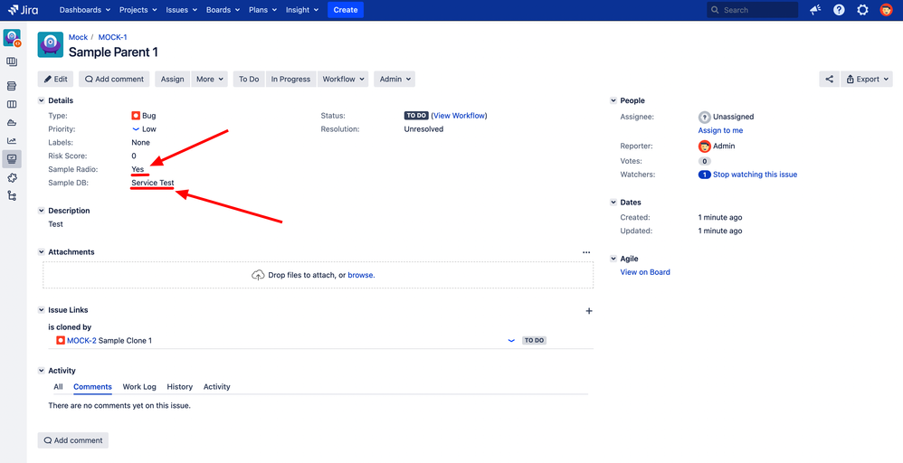

1. When the original issue is created, the values for the Radio button (Sample Radio) and DB Picker (Sample DB) are set to Yes and Service Test, respectively, as shown below:-

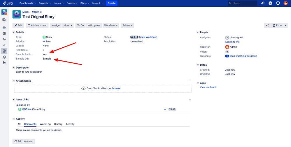

As shown below, the Sample Radio and Sample DB field values are visible in the original issue.

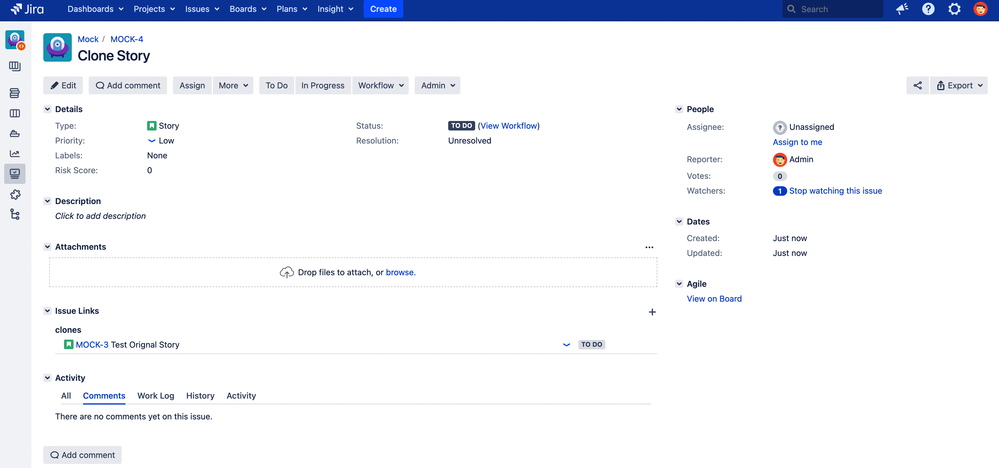

Once the issue is cloned, the values of the fields are removed and hidden from the view screen of the Cloned issue, as shown below:-
The same test was repeated on the Story Issue type and also works as expected, as shown below:-
