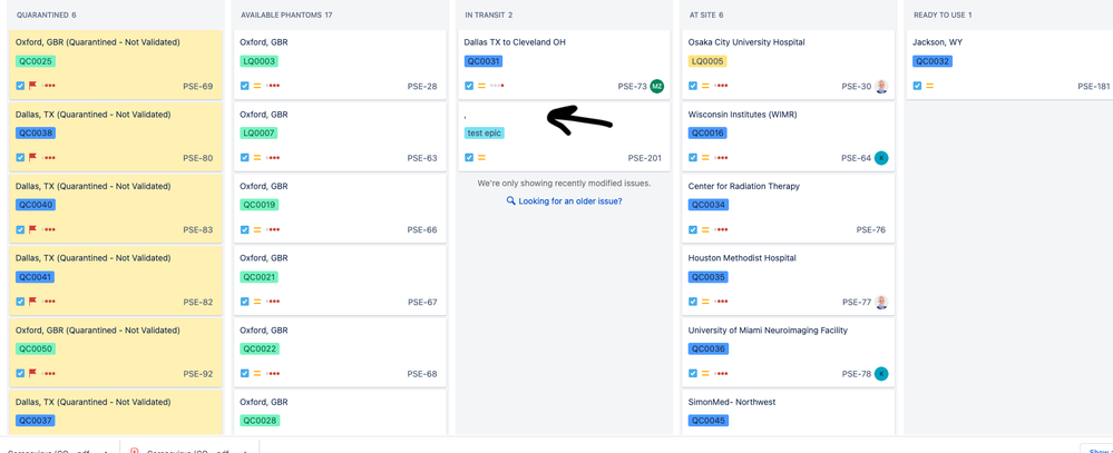

Hi all
I need to display the values of these custom field "(PSE) From" and "(PSE) To" to Summary field
I tried below automation but it does not work . Please help

Aysha.Mohammad July 27, 2022
rule is successfully executed but output did not get correct
John Funk
July 27, 2022
My example above was just using made up numbers for the custom field IDs. Did you look up the actual IDs for the fields you wanted to use?
