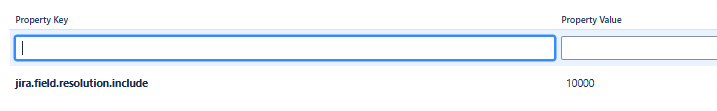

5. Explicitly included the Resolution id 10000, which is the Done resolution ID, on the transition Properties.

Does the transition include workflow properties that prevent the value you try to set ?
Originally, the workflow transition from UAT Validated to Done properties were empty, but to try to make it work I added it explicitly. Still didn't work.

You do not need the workflow property, it's sometimes used to include/exclude some resolution option during the transition. In your case it could have block you if the 1000 resolution was excluded.
Right. The transition properties definitely didn't and don't exclude the resolution, and I tried explicitly including the resolution, which didn't work. I just removed the inclusion and tried the automation again, and it didn't work. So, the properties don't seem to be the problem.

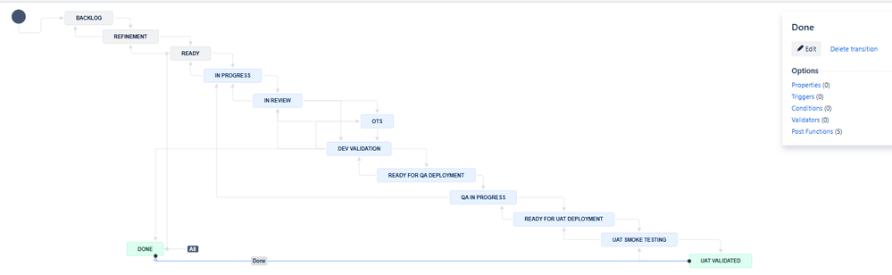

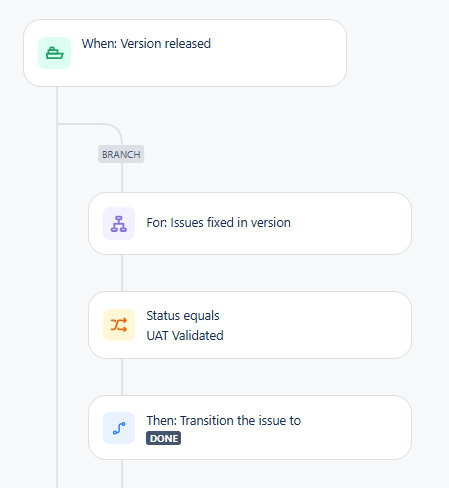

Can you add a screenshot of the Transition action ? As well as the Condition/Validator/PostFucntion of the transition itself in the workflow ?
Stewart_ Emily _ Global D_T March 28, 2025
Sure. There's really nothing much to them. As I mentioned above, I've tried the automation transition many different ways: (1) without any Resolution field, (2) with choosing the Resolution field and resolution value, (3) with Resolution id and value in the advanced edit, and (4) with Resolution name and value in the advanced edit.
