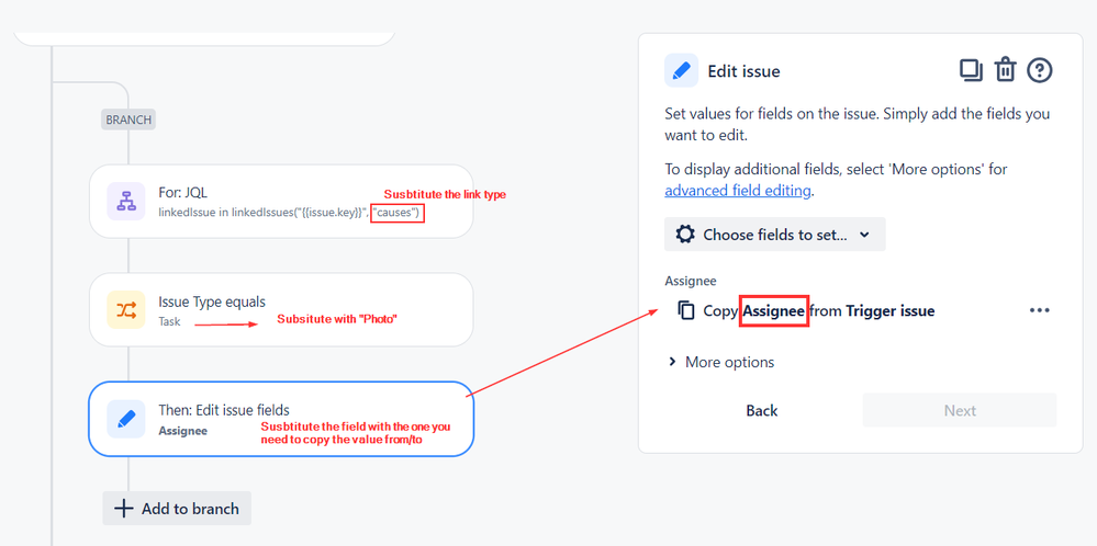

I have the 2 project issue : "Booking" and the linked issue name "Photo"
So I want to set up an automation that : When I change the status of Booking to Revision, the Photo will be copy the custom field X from "Booking" to "Photo" ( Both projects has that field X  )
So could you please help me how to set up the Automation

If I understood correctly you want to copy the value X from the issue type "booking" to the issue type "photo" when booking is transitioned to the status "revision".
You'll need to identify which link type you're using and adapt this automation:
The scope would be multiple-project.
I would say the linked issues match is optional but recommended if you want to limit errors.
Hope this helps.

Thank you for you help !! I also find out the same way and it works now.
Thanks againnn
