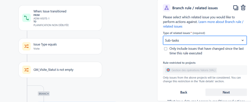

Loic
January 4, 2025
This is for when the status change scénario:
Child issue A = Visite
Child issue B = Evaluation
I tried Branch ruel using Subtask and Child issue.... THe audit log says: NO ACTION PERFORMED and No related issues could be found.

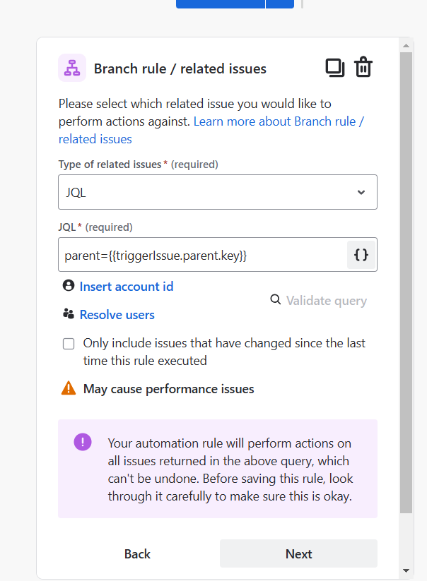

Trudy Claspill
January 4, 2025
Hello @Loic
Thank you for that additional information.
Using the Subtask branch would try to shift to subtasks of the issue that triggered the rule. Using the Child Issues branch would try to shift to child issues of the issue that triggered the rule.
What you really want is to shift to the sibling of the issue that triggered the rule.
To do that you need to use a JQL branch.
The JQL statement is saying "give me all the issues that have the same Parent as the issue that triggered the rule.
If the issue might have multiple siblings and you want only one specific sibling, then you can add more criteria to the JQL.
Like Rilwan Ahmed likes this
Loic
January 4, 2025
THANKS!! It works perfectly... Thank for you quick answer.
