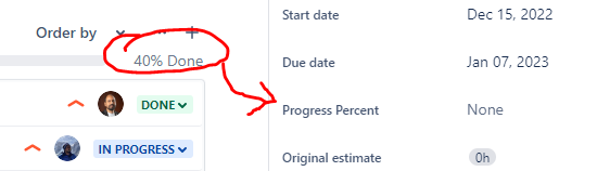

Hi All
I had a simple requirement to copy the done progress as shown here to a custom field "progress percent"
I tried everything but nothing worked.

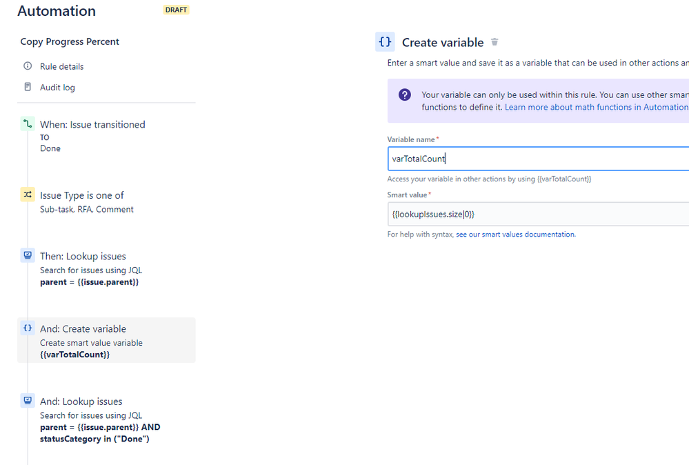

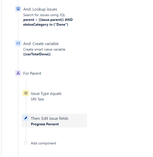

I still do not have a simple solution for above problem. I have tried the following workaround for recalculating the progress done percentage = issues Done / total issues.
I created one automation rule as follows.
Progress Percent Field is set to
{{#=}} ROUND({{varTotalDone}} / {{varTotalCount}} * 100,1) {{/}}
This works and may be helpful for others. But still sooking for simple solution of copying rather then recalculating all stuff.

Hello @Vinod Kotiya
There is no native solution for simply copying that information, as that information is not stored in a field. It is calculated on demand.
Depending on why you need that information you may find a third party app that provides a method to get the information for you without you having to use an automation rule to calculate and store it.
