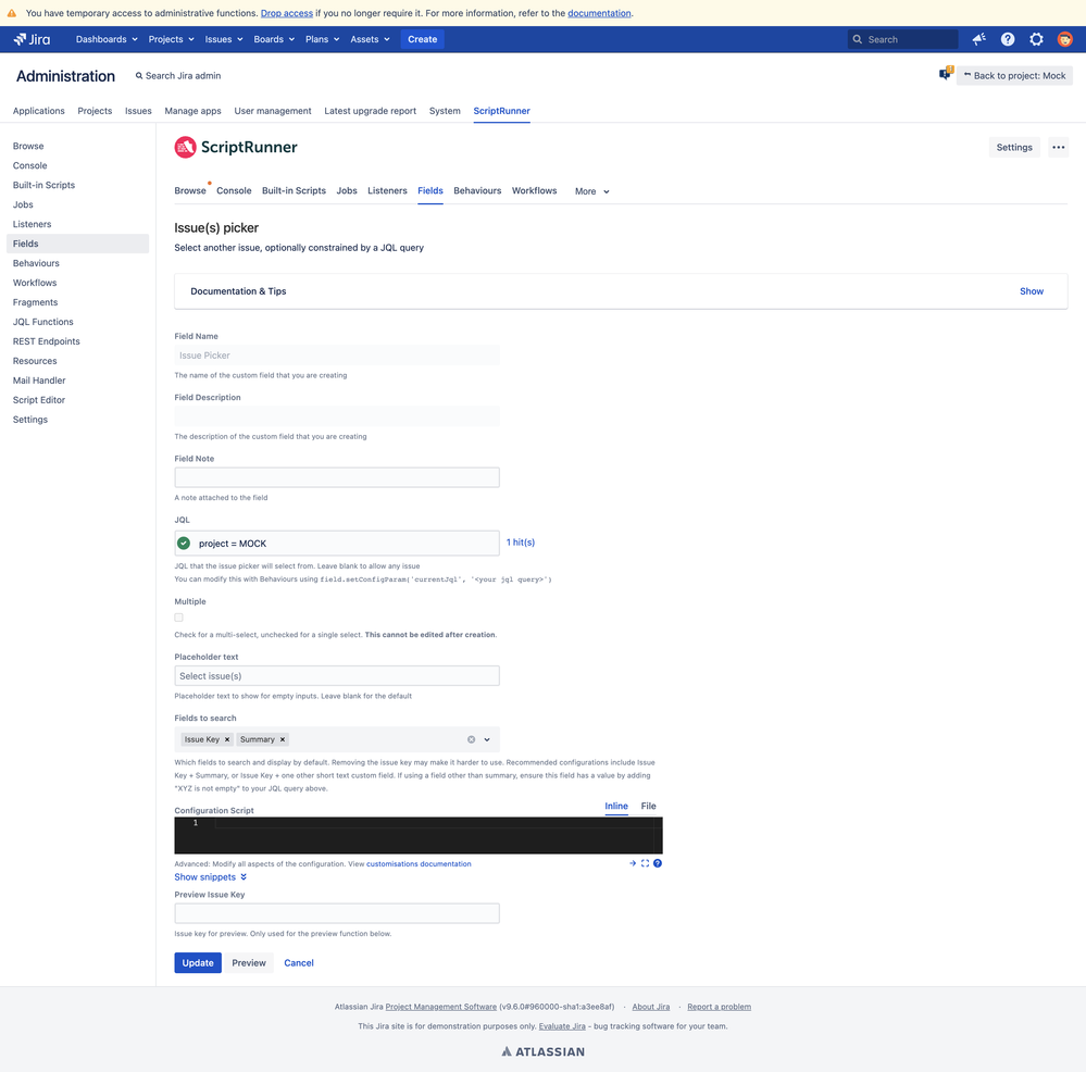

To proceed, I suggest you first create an Issue Picker scripted field so you can select the Parent issue from it.
Once the Parent issue is selected from the Issue Picker, you can invoke the values from the system field as well as the custom field(s) from the selected Parent issue and pass it to the Sub-task on the Create screen.
Below is a screenshot of the Issue Picker configuration:-

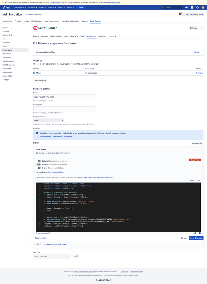

Next, you must create a Server-Side Behavior for the Issue Picker field.
Below is the sample working code for your reference:-

Below is a screenshot of the Issue Picker Behaviour configuration:-

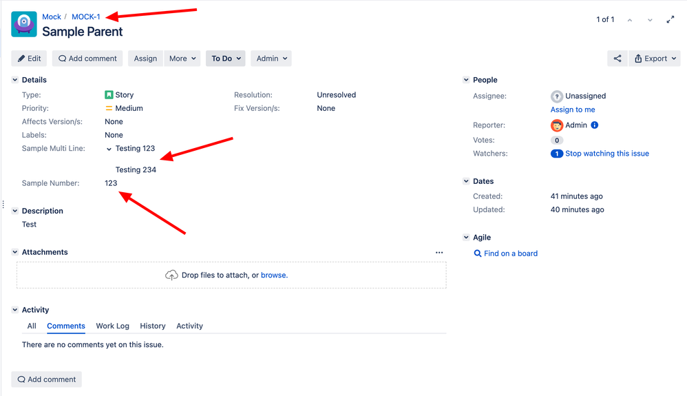

1. Below is a screenshot of the Parent issue. In it, 2 custom fields have been set with a value, i.e. Sample Multi Line and Sample Number.

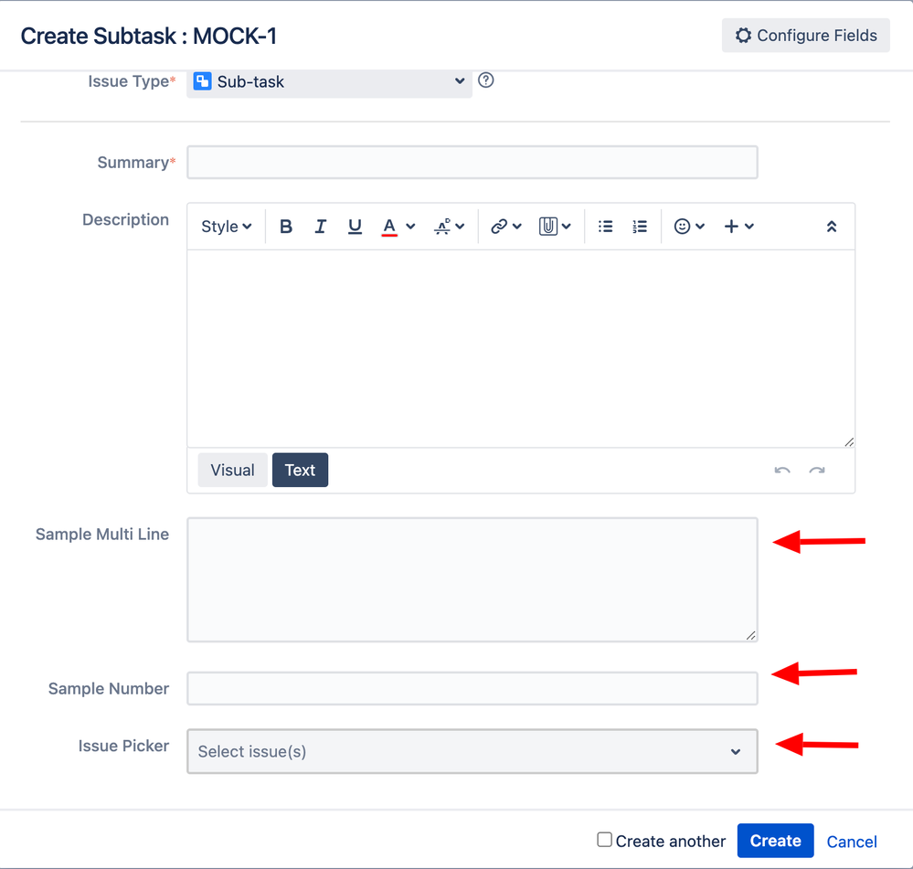

2. Next, with the Sub-task's Create screen, no values are passed into the Sample Multi Line and Sample Number fields as shown below:-

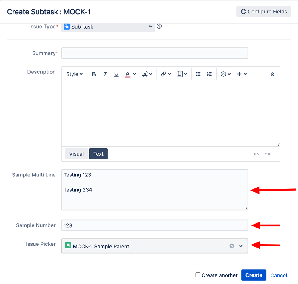

3. Finally, once the Parent issue has been selected from the Issue Picker, the values from the custom fields are passed to the Sub-task as shown in the screenshot below:-
