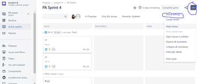

Hi @Irina_Palto
You need to write the filter for your board what kind of issue types or labels you want to display on board.
You can edit your board filter.
1. Go to three dotes on top right corner -> Board Setting -> general -> filter (edit filter)
If you have little but JQL knowledge you can edit the filter.
I hope it will help.
Monika
