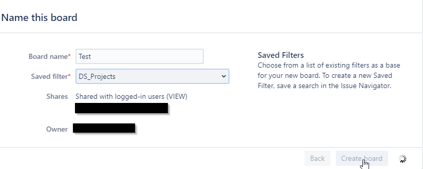

Hi @Chris K ,
you should be able to associate your filter based on issuetype=projects to a Kanban Board. Please make that filter shared and try to associate to your board.
Please could you share a screenshot about your issue ?

Hi @Fabio Racobaldo _Catworkx_,
Thank you for the hint. I made sure, that the filter is shared. When I try to create the board, I get a loading Icon (a view milliseconds) as you can see in the screenshot. After that, nothing happens, and I am able to push the button “Create board” again.
