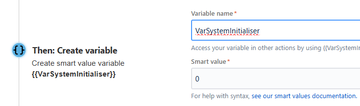

I can confirm that initializing the variable component, or rather its properties, is still necessary in 2025 (even on the data center). This is so that the variables can then be used in the conditions and after the conditions. You can easily check this using the logs component. I always use an initializer at the beginning of the ARU (it doesn't need to have the same name as your variables used in the conditions; here, we simply load the properties of the component upstream of the ARU so that it can work throughout the ARU):
Then you use a “for each” on a smartvalue defined to a single value, which is a strange choice. This is not a ticket field here, but rather a smartvalue created in the ARU. I advise you to approach things algorithmically in order to take a step back from the composition of the ARU and clarify your problem.
