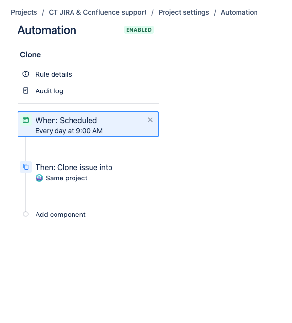

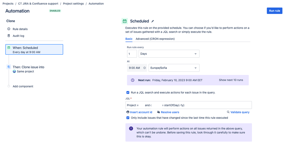

Hi @Vladimir Sumilin ,
You can try to built this automation:
The JQL I would use in this case as part of the scheduled trigger is Project = xxx and training date = startOfDay(-1y)
Hope it helps!

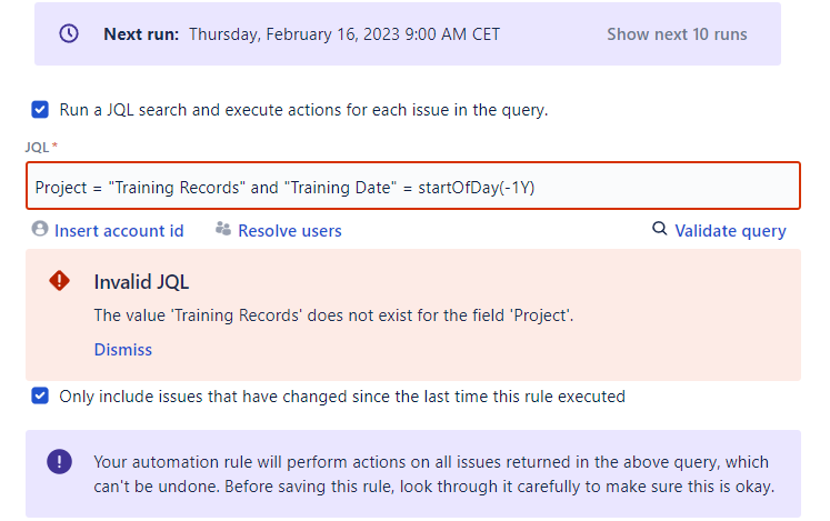

I'm getting an error when I'm trying to make it as you said:
Kelly Arrey
February 9, 2023
Try `Project = "Training Records" and "Training Date" - startOfDay(-1Y)`
  • JQL doesn't recognize Training Records as a project name without the quotes
  • Similarly JQL doesn't recognize Training Date as a field name without the quotes
  • Don't forget the Y in "startOfDay(-1Y)"

Vladimir Sumilin
February 9, 2023 edited
Hey Kelly,
Thanks for the reply, but I still have an error:
Kelly Arrey
February 9, 2023
Augh!!!! I had a typo in my response to you. My apologies. Try:
`Project = "Training Records" and "Training Date" = startOfDay(-1Y)`
Sorry about that.
Like • Vladimir Sumilin likes this
Kelly Arrey
February 9, 2023
But it seems that "Training Records" is not a valid value for the "Project" field in your Jira instance, so I think you'll need to figure out what project you want to query, or investigate whether your Jira instance has two fields named project.
Like • 2 people like this

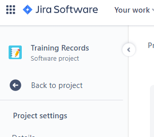

Magdalena Zhisheva
February 9, 2023
I would add to use project key instead of the project name.
When I have troubles with JQL in Automation rules, I usually go to Filters -> Advanced search in a new tab and build the query there first with the suggestions list, so I can be sure that it's working. Once it's working,  you can paste it to the Automation rule.
Hope it helps!

Vladimir Sumilin
February 9, 2023
Thanks for your replies,
Jira can understand now the project name, because I am using only the project key, but he gave me another error about startOfDay.

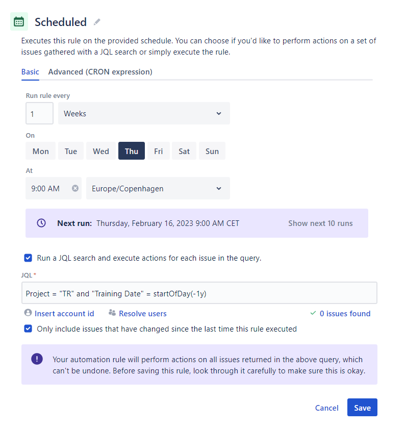

Vladimir Sumilin
February 9, 2023
I found out why I had the last problem because Y should be small y and then it's working. Thanks for the help guys! :)
I have only one concern that it says it will start the next Thursday. Please check the screenshot below:
Is the basic also working or I chose that JQL only will work?
Thank you anyway! :)
Magdalena Zhisheva
February 10, 2023
Please, check my screenshotScreenshot 2023-02-09 at 11.14.13.png You may schedule to run every day, so the JQL check will trigger any further actions.
Let me know if you need any other details
Vladimir Sumilin
February 10, 2023
Hi Magdalena,
I'm confused now. I will try to explain my concern.
I have this query in JQL:
Project = "TR" and "Training Date" = startOfDay(-1y)
My question: is it only this query working? (I need to make it only once a year)
But for me it's saying that it will run next Thursday, what I actually don't need.
Best regards,
Vladimir
Magdalena Zhisheva
February 10, 2023
The rule I proposed means:
Everyday perform a search for tickets where the training date is on the same date last year  and clone it.
So you need to schedule it to perform the check every day and if there is an ticket with a training date on the same date last year, it will be cloned.
Hope it makes sense!
