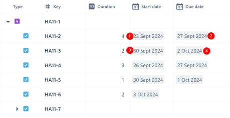

I need help with the following issue.
This is my automation:
  1. Trigger: Value Changes for Start date, Duration
  2. Then: Edit issue field Due Date (=Issue Start Date + Duration)
  3. And: Re-Fetch issue Data
    1. Branch For Linked Issues, Types: Linked issue cannot start until this issue finishes
    2. Then: Edit issue field Start Date (=Linked issue DueDate+1day)
    3. And: Re-fetch issue data
    4. And: Edit Issue fields Due Date (=Issue Start Date + Duration)
    5. And: Re-fetch issue data
This is the problem:
  1. I manually update the Start date of HA11-2
  2. Then the Due date of HA11-2 get's updated. This is OK
  3. Then the Start date of HA11-3 gets updated. This is OK
  4. Then the Due date of HA11-3 gets updated. This is OK
Then it stops, but the rest of the issues are linked as well. I am expecting all linked issues to continue updating.

Hello @Alanis_ Hans
How are the issues linked? Is HA11-4 linked to HA11-2 or to HA11-3?
The rule you have written will change only the issues that are directly linked to the trigger issue - HA11-2.
If your issues are linked in a chain, then on the Rule Details page you need to check this box:
Then the update of HA11-3 will cause the rule to be triggered again for HA11-3 and update the issues linked to HA11-3, and so on through the chain of linked issues.
However this sort of trigger-itself action is limited to 10 such executions. If you have more than 10 issues in the chain additional actions have to be taken to address that.
