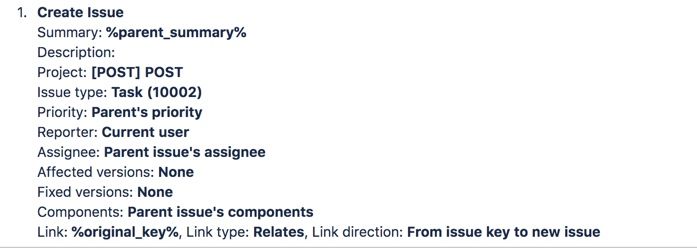

We assume that you want to create a subtask in your target project(say POST) when a transition happens in the source project (say TES). Please add the below-given post functions.
Add a "Create Issue" post function on "To do" transition on TES project.

With the above, When "To Do" transition happens on an issue in TES project, a TASK gets created in POST project along with a subtask that gets linked to the newly created issue i.e. TASK.
Please note that the above works when you have different projects with different workflows.
