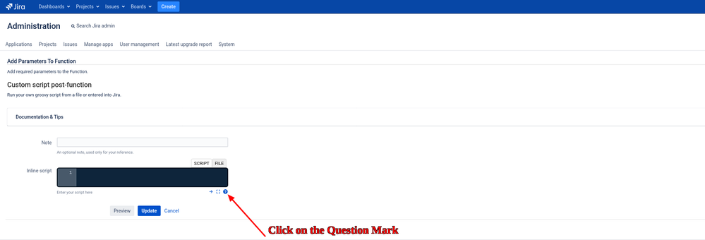

To see which keyword you can use, click on the question mark symbol as shown in the image below:-

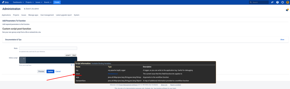

Once the question mark symbol is clicked, you will be shown the in-build variables as shown in the image below:-
So, in your code, instead of using:
put("/rest/api/2/issue/ITS-53")you could use:-
put("/rest/api/2/issue/${issue.key}")
