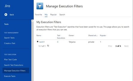

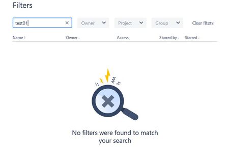

As it is shown in the screenshot above, I'm an Owner of 'test01' filter, when I run search via "View all filters" the 'No filters were found to match your search' is returned to me.
As far as i can see this is specific filters from Zephyr App. I've created such filter and then tried to delete it through "Manage Execution filters" section and no luck.
This page says that execution filters can be modified, shared, deleted etc. from the Manage Execution Filters page.
https://zephyrdocs.atlassian.net/wiki/spaces/ZFJCLOUD/pages/21757989/Search+Test+Executions
But when i click on any filter from this page it just runs the filter and not showing any preferences like "Share" ,"Edit" or "Delete".
I'm not sure but it seems to be there some issue with app and you probably should contact Zephyr Support.
