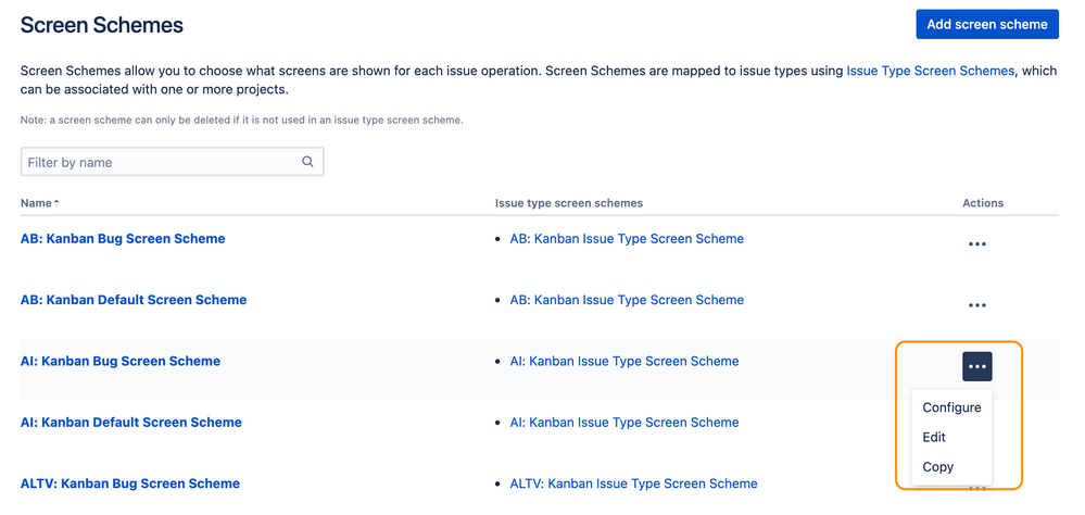

I have troubles in finding the delete options for the schemes. We have many unused onces, not associated with any project, which make me have nystagmus while changing/setting anything.
Could you advise how to find this option? Where should the permissions be changed if the problem lies there? Screenshot 2021-10-15 at 16.24.32.png

First, you will need to remove the screen on any screen scheme on <YOUR_JIRA_SITE>/settings/issues/screen-schemes. Then the delete option will be enabled for that screen.
You might also need to review your Issue Type Screen Scheme and remove Screen Schemes that are not being used <YOUR_JIRA_SITE>/settings/issues/issue-type-screen-schemes
