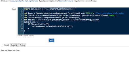

Try this, replace issue key with actual issue key and test it in staging environment first
def issue = ComponentAccessor.getIssueManager().getIssueObject("TEST-1") // get issue where field exist
def customField = ComponentAccessor.getCustomFieldManager().getCustomFieldObjectByName("Your CustomField Name")
def optionsManager = ComponentAccessor.getOptionsManager()
def options = optionsManager.getOptions(customField.getRelevantConfig(issue))
options.each {
if (it.getDisabled()){
optionsManager.deleteOptionAndChildren(it)

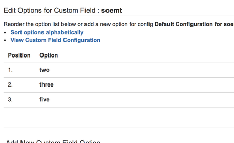

I believe the script will delete the "custom field" from the issue where the the field exist. However my question is different, i want to delete the options value from the custom field, i have enclosed the screen shot for your reference.
Basically when we go to Admin>Issues>Custom Fields>Configure>Edit Options . So there are many custom field options, so what i want is to delete those option values which are disabled. In the screen shot there are 5 CF values, out of which we need to delete only (#2, #4)
And script above will delete this options from configuration.
It looks strange, because optionsManager need some context. It is architecture feature.
I ve tested it on my environment and it works.

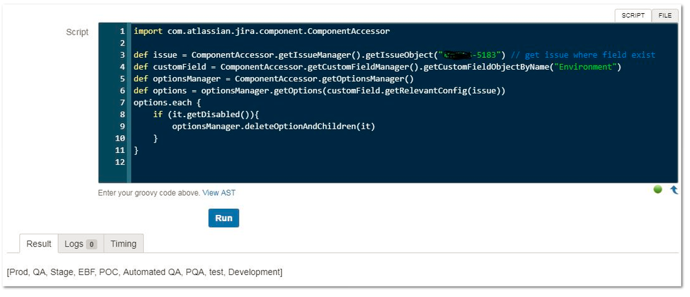

Any issue key, where field exists on the screen.
So according to you, when we pass any issue key in variable, so option under that field will be deleted from field config? What i concerned about, this should not delete the custom field.
i ran this script from script console (script runner), however it not doing anything. Means, neither it deleted the option from issues nor under custom field config. Rather printing the output like above:
This output is normal.
Are you sure that it not deleted from config?
I ve checked it again and it
