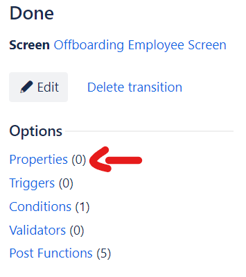

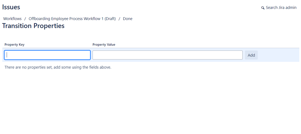

Is it from here?

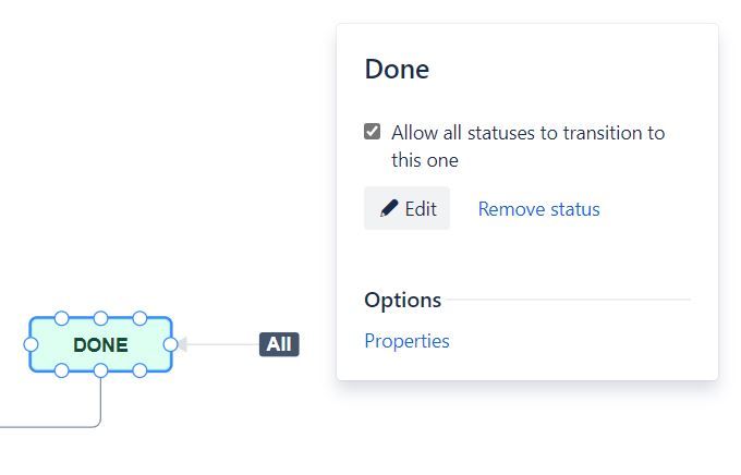

Hi @Yousuf Al Rawahi - your screenshot is for the transition property, to prevent updates you need to modify the status property instead.
Instead of clicking on the Done transition, click on the Done status to access the property screen for that status (under Options section).
Then you can enter the required property values (eg. jira.issue.editable = false).
You might also want to add the status property jira.permission.comment.denied to prevent comments from being added when the ticket is in the Done status.
