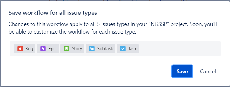

102_Miguel January 6, 2021 edited
Thank you, I will follow your suggestions.
At first try I got the message attached
Dirk Ronsmans
January 6, 2021
Seems you are working on a Next_Gen project? That is a bit different yeah..
Yes, it's a Next-Gen Project
