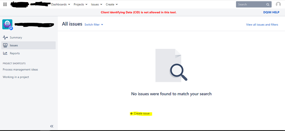

How to disable "+ Create Issue" button from project section.
Sambit Choudhury June 30, 2022
I am also facing same problem due to this "+ Create Issue" button in projects sections. This button is creating issue bypassing mandatory fields. We are using Script Runner plugin for the customfield behavior using groovy scripts.
This is a challenge for us, few users created issue using this button by mistake and ended up having no mandatory fields populated.
This project is a "Company Managed project", but if you can let me know how to get this property of project.
We have customized JIRA to accommodate with our requirement of work flow management tool.
We are using "Atlassian Jira Project Management Software"
Please suggest us any work around or any solution to disable this "inline issue creation" block.
projectSection_CreateButton_screenshot.PNGprojectSection_CreateButton_screenshot1.PNG

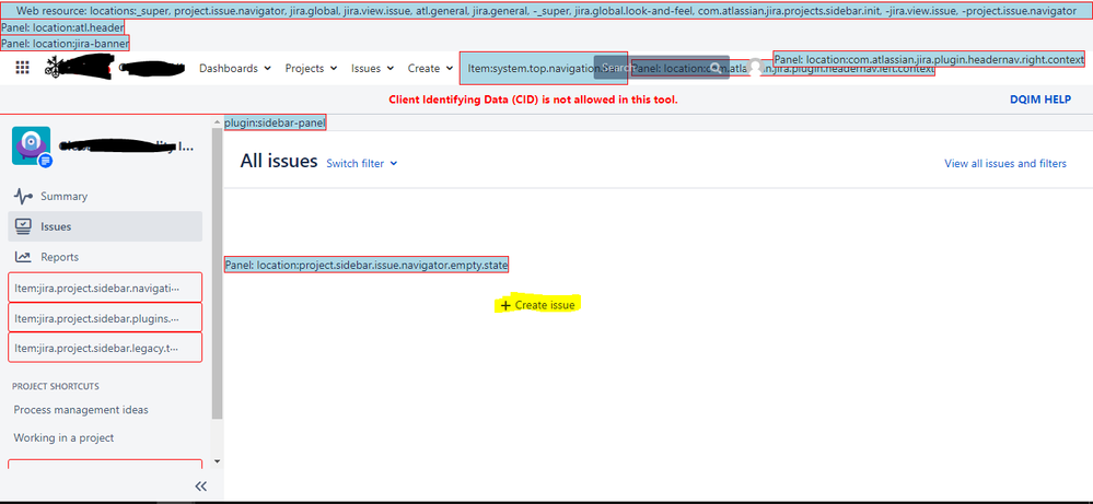

      3. There is no fragment found for "+ Create Issue" using Fragment locator. Below is the screenshot.

If you can let me know which UI element is this "+ Create Issue" in projects section. So that I can try hiding in Fragments.
