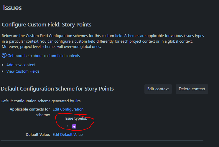

I have been in touch with support, unfortunately the story point field can only be hidden, not replaced. There is a feature request to customise the child issues view: https://jira.atlassian.com/browse/JRACLOUD-70206
To hide the story points field from child issues you can edit the context of the custom field Story Points and remove "Stories" from the issue types.

Simon Otten September 3, 2024
Yeah all boards I have are set to Original Estimate / Time Estimates and I have removed the Story Points field from all issue types. I'll see if anyone has a answer and will otherwise raise a bug. Thanks for your reply
