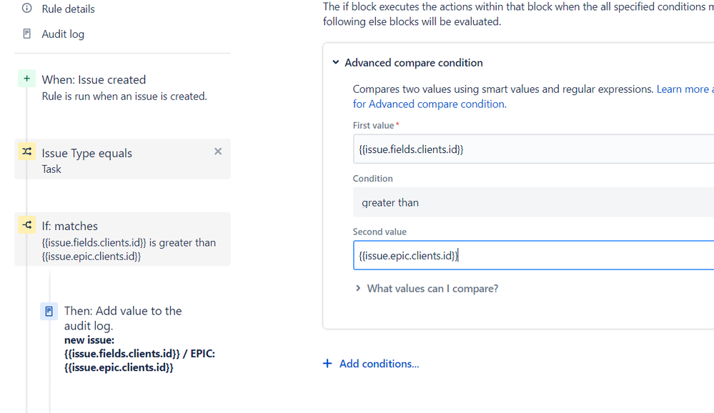

You could either use REST API to retrieve this single select ID, or use a 3rd party app, like JMWE or scriptrunner to do the comparison on the create screen of your story workflow, or use smart values within a Jira Automation. The latter could be easier.
For example you could do the following with Jira automation:
And then on the audit log you would have these results:awesomeRuleResults.png
Thus having two integers value to compare!
Happy ending, no? :)
