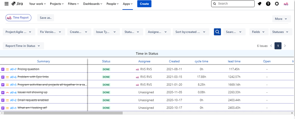

This data is difficult to get out of the box. If you would be interested in a ready made solution, one cheap and efficient solution that we have developed is Time in Status Reports . It lets you display the time in each status in an easy to read table, with configurable working hours setting. The app provides the following features
 Time in Status :- More than 7 types of Time in Status reports to track your issues. You can also group your statuses to define your own cycle time/lead time/time to resolution
