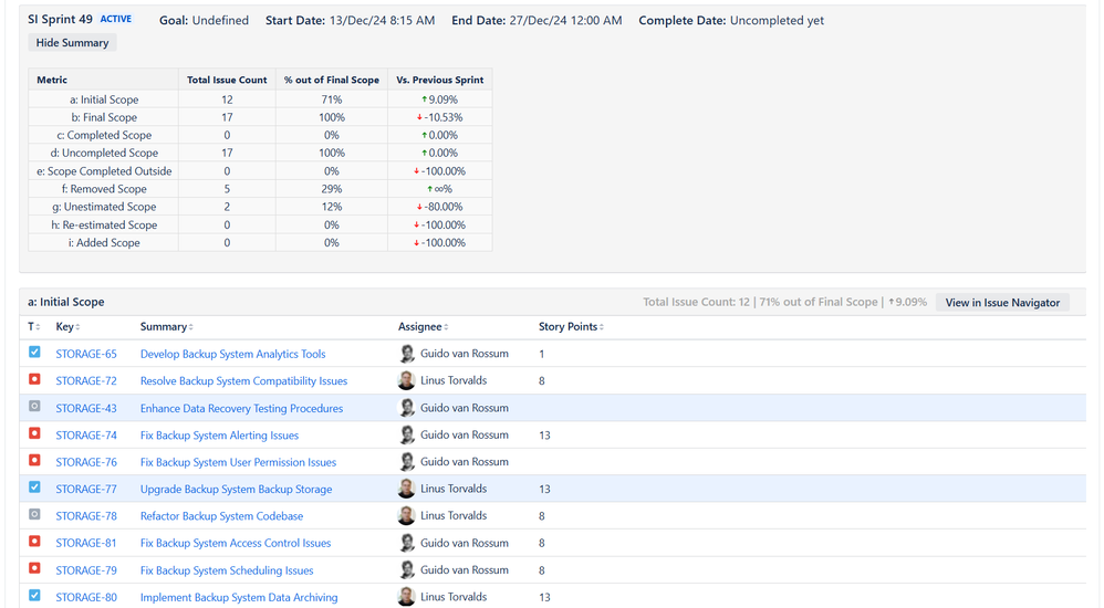

In case you want to try an app, our Great Gadgets app offers a powerful Team Velocity gadget that allows you filter the sprints displayed by time range or by name.
The gadget is highly customizable, works with any type of estimates, can include sub-tasks, offers additional metrics (such % completion, scope changes, etc), and can display a Data tab with detailed data about every sprint.

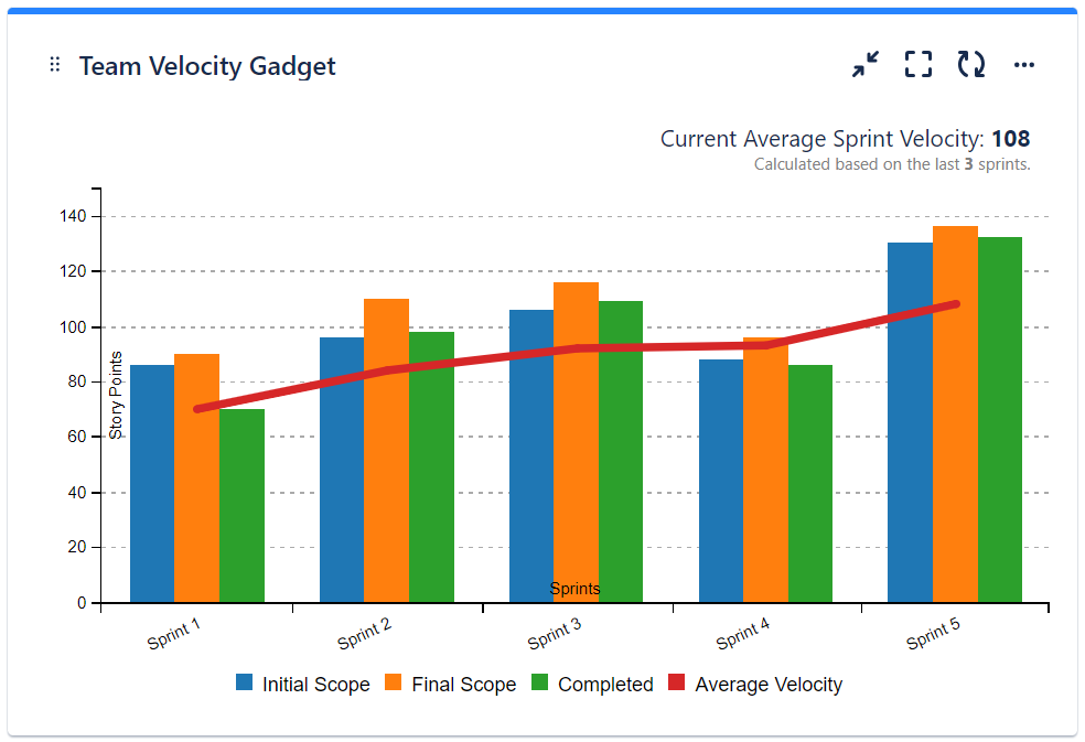

As suggested by Humashankar, a mktplace app can help here. If you would be interested to try out one, pls do take a look at
Agile Velocity & Status Gadgets
The app comes with few dashboard gadgets to track team member's / team's velocity / productivity based on story points / time spent / issue count in a sprint  and also track sprint status with multiple parameters. The app works for past / closed sprints too and can be used to display data for specific sprints as well.
Disclaimer : I am part of the team which developed this app
