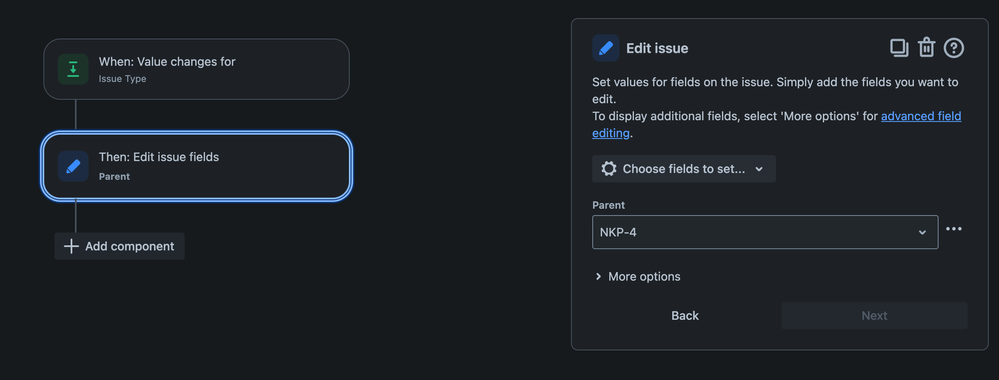

    • Automation: You can create an automation rule that triggers when a sub-task is converted to a story, automatically linking it to the parent epic based on a field or condition. But if each issue needs to be assigned to a different epic, then you might have to include some conditions and branches to check the epic linked to the parent and then to copy it to the issue
      Example rule:
