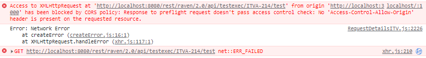

I tried to make a get request, but I have a following issue;
Request: http://localhost:xxxx//rest/raven/1.0/api/testexec/xxxx/test
My WebApp works fine with Jira Rest APIs but not with Xray Rest APIs.
Should I enable an option in JIRA server for Xray?

That's the browser blocking the request to Jira because of CORS.
Jira doesn't send the Access-Control-Allow-Origin response header (see JRASERVER-65362 ) so you might not be able to call that API from your other web application.
You may want to test if that's the issue by disabling CORS on Chrome and trying the API.
If that resolves the issue you may need to enable the CORS filter on the Tomcat level.
I hope that helps.
