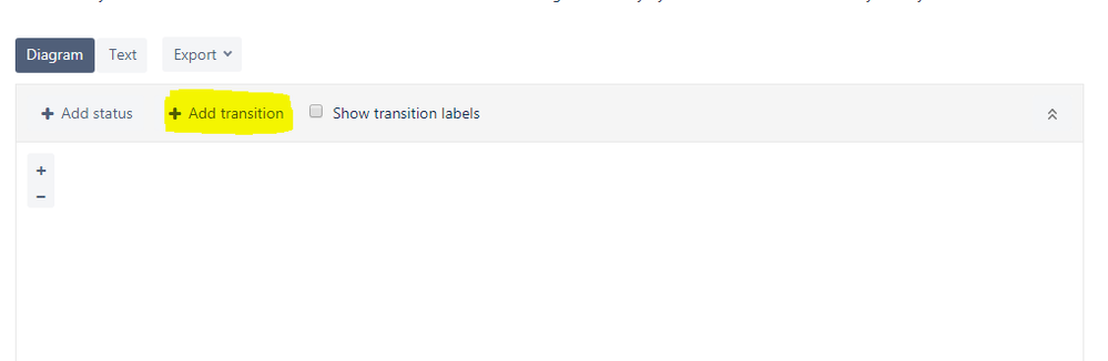

I have opened workflow.In my instance i could find any transition id.please find attached screen .where i can get this transition id.
please find attached workflow screen.
Alexey Matveev
May 21, 2018
Go to the text tab (not Diagram). You will see numbers near transitions. That would be the transition (action) id.
