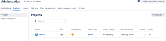

Under Administration > Projects there's a column where you can see the last time an issue was updated in the project.

@Edwin Kyalangalilwa, is that an image from Cloud? Not sure it is and I do not have that field in my Projects page and I checked another instance as well w/o success. I wonder if this is Server specific?

You're right, i missed that this is a question related to cloud.
@Narendra Kumar Please disregard my above answer.

Hi @Edwin Kyalangalilwa yeah this is not available for cloud instance.

This is now available in CLOUD! See Screenshot from one of my cloud instances... Yup, you can now see "Last Issue Updated" and sort by that in the manner @edwin mentioned above!
