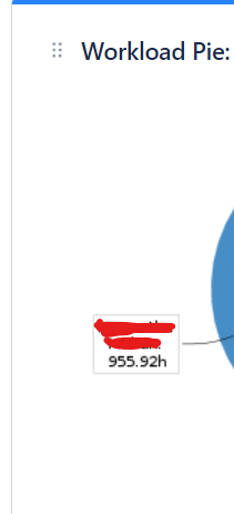

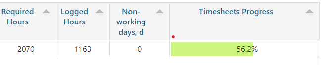

I wanted to get the time logged to a particular project by a particular user for a specific period of time. I tried the below query and found that the workload was 955.92 hrs. However, when I cross-checked the same with the timesheet (Activity timeline application) there is a difference of 207.08. In the timesheet its actually 1163 hrs.
project = ABC AND worklogDate >= "2021/09/01" AND worklogDate <= "2022/06/26" AND worklogAuthor = XYZ order by created DESC
Can you guys help me out how to get it correctly on the dashboard.

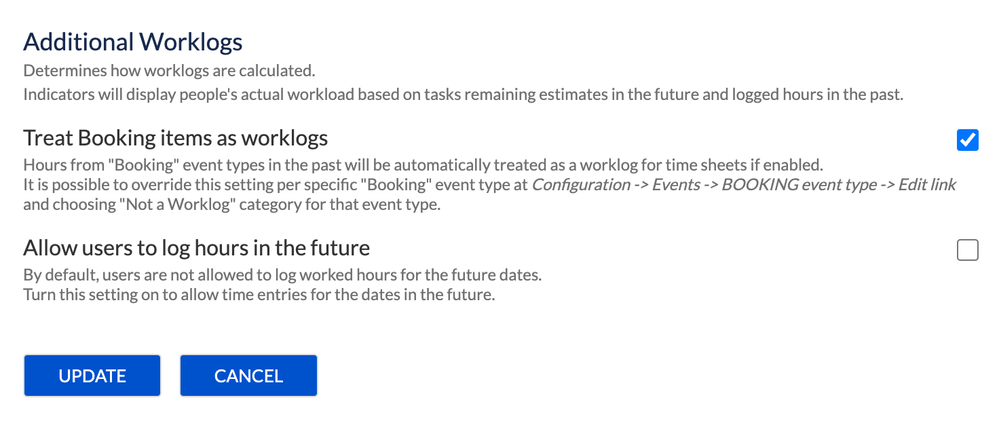

This is controlled by the following ActivityTimeline setting:
ActivityTimeline Configuration -> Timesheets Config -> Treat Booking items as worklogs (screenshot below)
You may uncheck that checkbox and click Update button so tell ActivityTimeline to ignore Booking items in the past and do not calculate their hours into user's total worklog hours.
