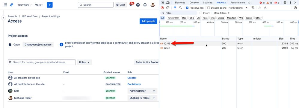

Instead of using the ID found through the API, you can find the project role value needed for this workflow property through inspecting the page / reviewing the Network tab when switching a user's role. For example if I were to assign a user as a project admin in a team-managed project, the browser log shows this:

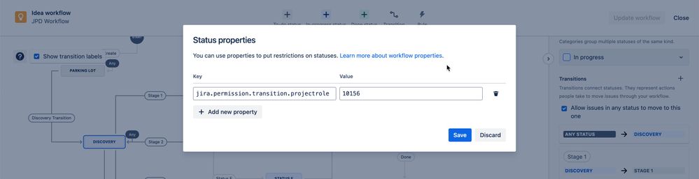

Which can then be entered into a status property to only allow project admins to transition an issue moving forward with something like this:
