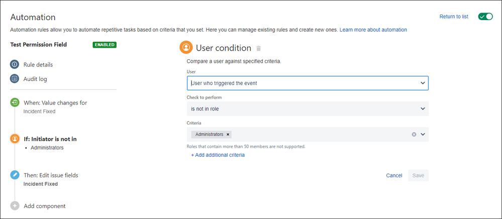

In an issue type, I have a custom field named Incident Fixed (Date Time Picker Type). For this field, I want only users with project role Administrator can edit it, other users are not allowed to edit.

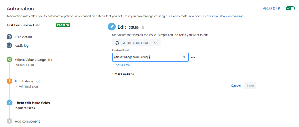

Here's how I configure:

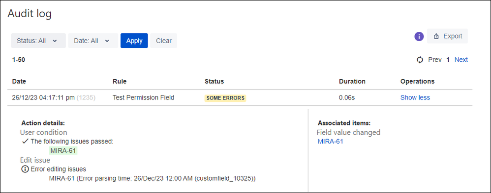

I checked the audit log of automation rule and got below error.
I'm not sure what "error parsing time" is. Please assist to help me to solve this error.

In your rule you are using the {{fromString}} smart value for the field, and it appears the text cannot be parsed correctly as a date / time: https://confluence.atlassian.com/automation/smart-values-993924860.html#Jirasmartvaluesissues-fieldChangefieldChange
There are two things you could try:
Bill
Hi @Bill Sheboy
I tried with Option 1 and it worked!!!! Your provided documentation links are really helpful. Appreciate it!!!
