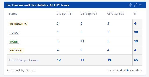

You can use the Sprint as a value in dashboard gadgets. Would that work for you?
Capture.JPGTom
