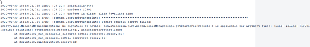

I tried to get all boards according to different projects by implementing a script in scriptrunner. Unfortunately, I'm not able to come to a result when I try to use BoardManager or BoardService.
Here is my code snippet:
projects.each{project->
log.debug"project: "+project.id
log.debug"project id class: "+project.id.getClass()
def b = boardManager.getBoardsForProjects(project.id)
log.debug(b)
 And here you see the error message:
I do not understand why the signature of the method "getBoardsForProjects()" is not correct.
Thanks for your support in advance!

Günter Halmans September 30, 2020
Hi Niranjan,
oh what a silly typo...thanks for this hint!! Now I don't get an error message from the system anymore.
But to be honest, I only reached the next question...the list of the boards as a result of the boardManager method "getBoardsForProject()" is empty, although the projects have boards.
So I guess there is another problem beneath the typo...any additional idea?
Thanks!
Best regards,
Günter

Hi @Günter Halmans - I believe that is getBoardsForProject(long projectId) and not getBoardsForProjects(project.id)
