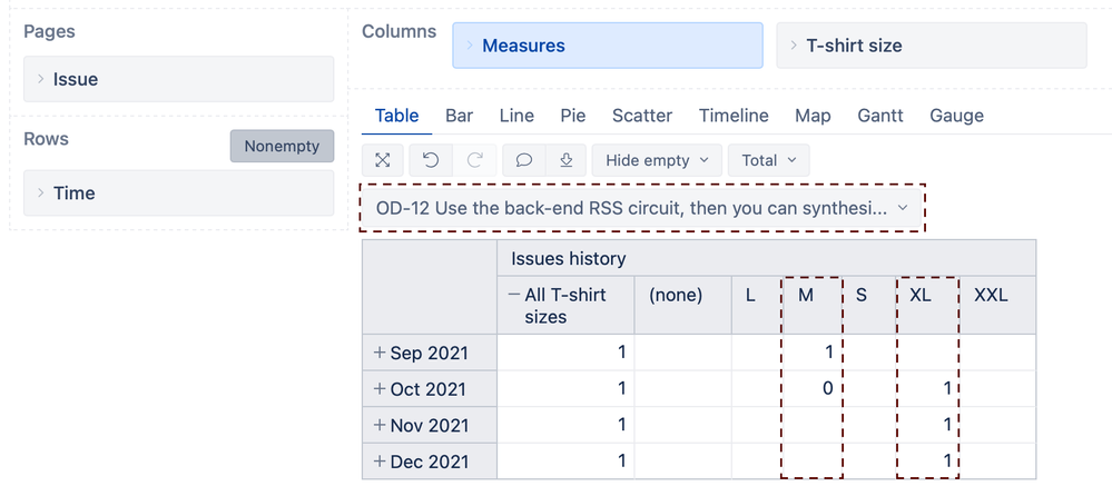

To see the value change for one specific issue, you can create a report similar to the one below:
There you can see the custom field "T-shirt size" value changed from "M" to "XL" in October.

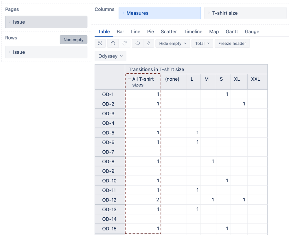

Another option is defining a calculated measure to look for the number of changes to the field. For example, in the case of the custom field "T-shirt size", the calculated measure formula could look similar to the one below:
([Measures].[Transitions to],
[Transition Field].[T-shirt size])
The measure "Transitions to" and the dimension Transition Field are hidden from the view as their potential is fully exposed in calculated measures. With the Issue dimension in rows, you can see the number of changes in the particular field for each issue. See the picture below:
The measure also includes issues created with the custom field. So, if a value was changed, the column for the dimension "All" member will have a value greater than one.
