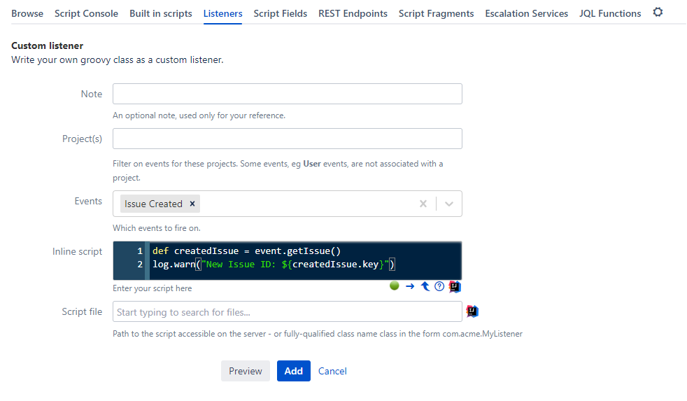

Thanks for reply. As iam completely new to JIRA.i am using this script in listener issue created . now when issue is created in jira then i want to capture issue id and then i want to perform operations. Will above code will work which u gave. If yes how to check whether id is there in logs
Yes it will work when you configure your listener for Issue Created event. here is how your setup will look like:
Thanks it worked.
