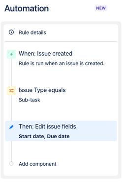

Here is Rule #3:
A clever part of this rule is the Edit Issue action.
First you have to select the field you want to edit. (Note that you can edit more than one field in the action.)
After you select the field, initially you'll see an empty field where you can enter the value you want to assign to the field. The clever part is you can actually select to Copy the value from the parent issue thus:
Click the three dots to the right of the field and select Copy.
That changes the entry field to look like this. Then click on the text displayed in the entry field.
When you click on that text you get a pop-up where you can change the source issue you want to copy from, and even the field you want to copy from. You would want to select Parent Issue as the source.
Screenshot 2023-11-14 at 9.46.23 AM.pngScreenshot 2023-11-14 at 9.46.33 AM.png
That's it for Rule #3. I'll post a separate  response about an example of Rule #1/#2.
